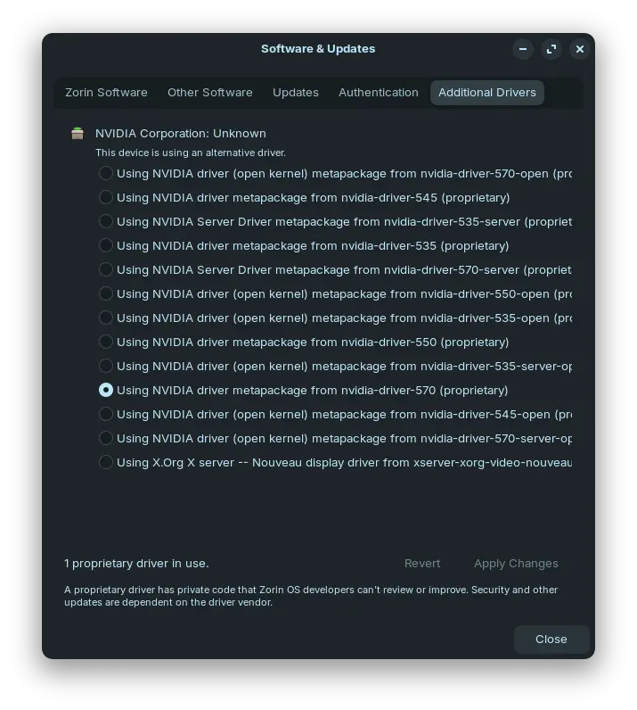

Update Manager programini calistir, additional driversa gel, fotograf at.
