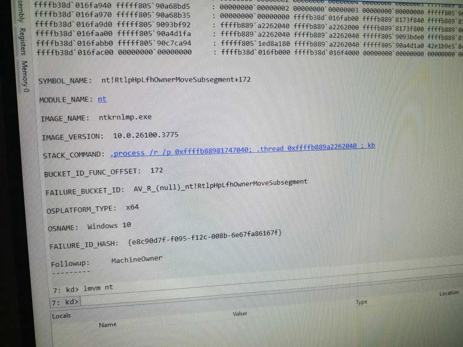

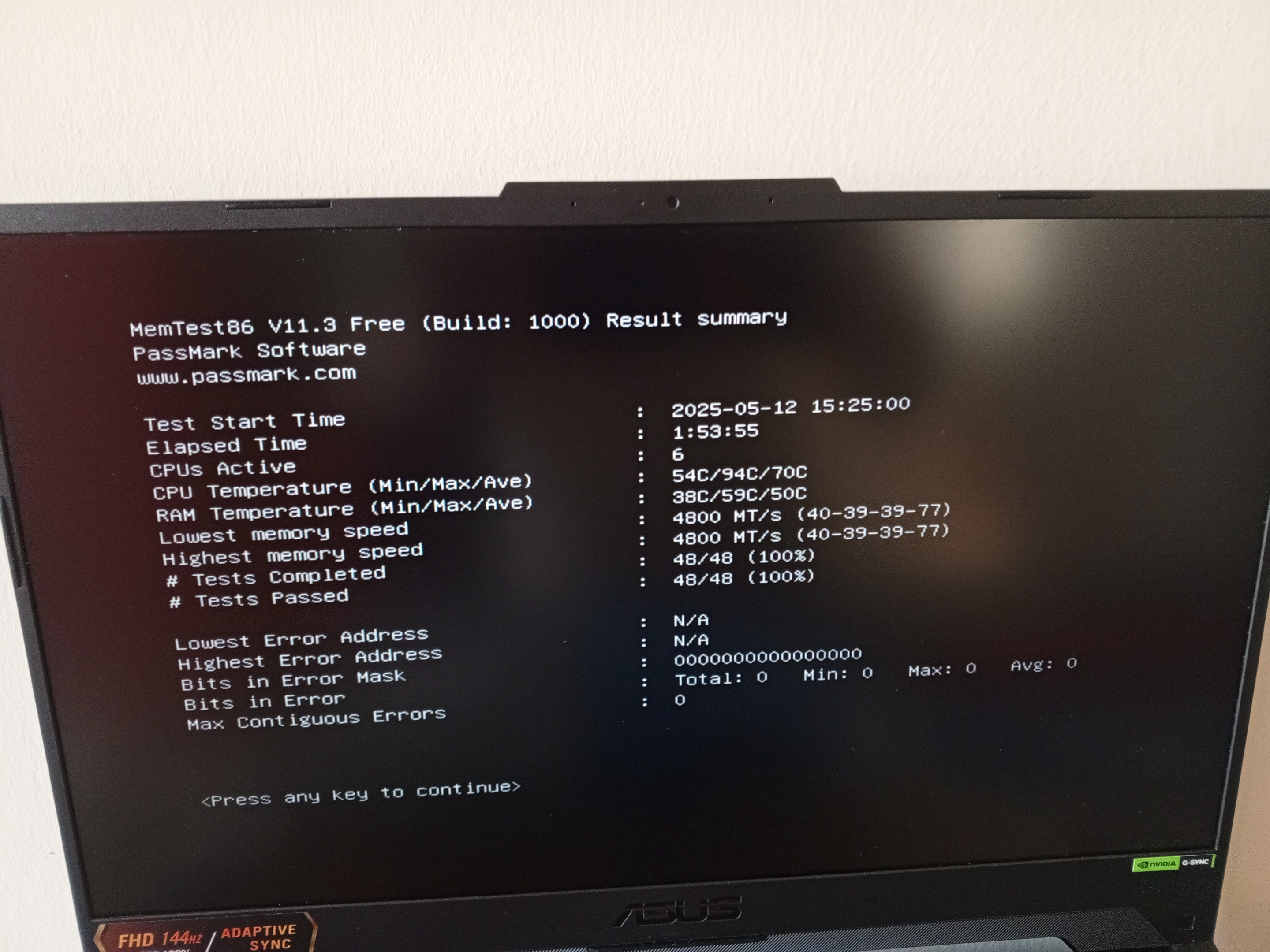

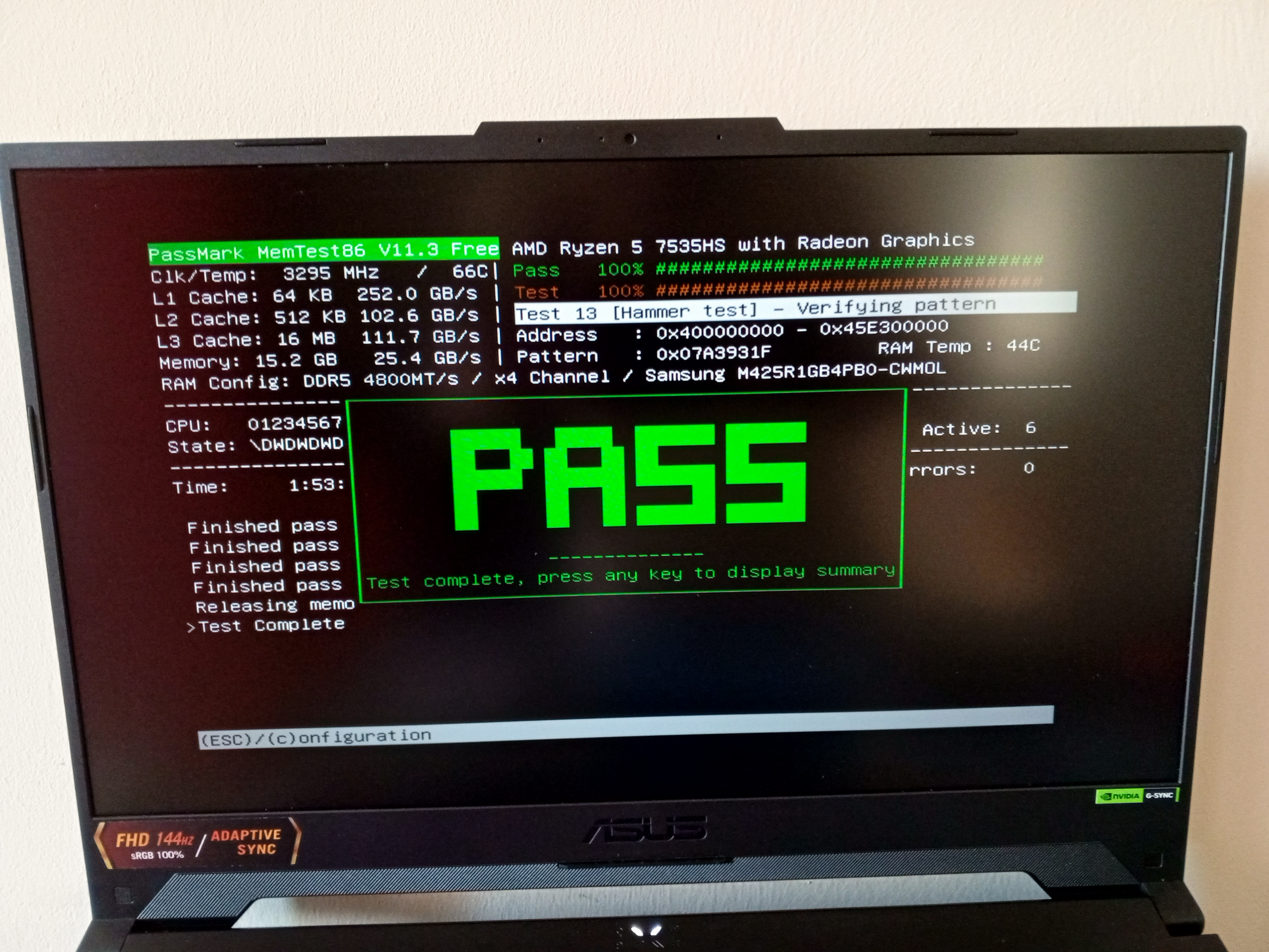

Merhaba, dün format attım ve driver yüklerken bir sorun oluştu, mavi ekran verdi sistem. RAM'lerden şüphelendim ama sanki değil gibi Memtest86 uyguladım. @Recep Baltaş yardımcı olursanız çok memnun olurum. https://disk.yandex.com.tr/d/ZQQ5Kz0aaMYzyw
Emin olmamakla birlikte ses kartı sürücüsü kaynaklı gibi ama durumu gözlemleyin derim.

BUGCHECK_CODE:  50
BUGCHECK_P1: ffffcb0a00000008
BUGCHECK_P2: 0
BUGCHECK_P3: fffff80590a25636
BUGCHECK_P4: 2
FILE_IN_CAB:  051125-13000-01.dmp
DUMP_FILE_ATTRIBUTES: 0x21008
  Kernel Generated Triage Dump
FAULTING_THREAD:  ffffb889a2262040
READ_ADDRESS: fffff805915c34c0: Unable to get MiVisibleState
Unable to get NonPagedPoolStart
Unable to get NonPagedPoolEnd
Unable to get PagedPoolStart
Unable to get PagedPoolEnd
unable to get nt!MmSpecialPagesInUse
 ffffcb0a00000008
MM_INTERNAL_CODE:  2
BLACKBOXBSD: 1 (!blackboxbsd)
BLACKBOXNTFS: 1 (!blackboxntfs)
BLACKBOXPNP: 1 (!blackboxpnp)
BLACKBOXWINLOGON: 1
CUSTOMER_CRASH_COUNT:  1
PROCESS_NAME:  System
STACK_TEXT:
ffffb38d`016fa078 fffff805`90873351     : 00000000`00000050 ffffcb0a`00000008 00000000`00000000 ffffb38d`016fa2e0 : nt!KeBugCheckEx
ffffb38d`016fa080 fffff805`908913cf     : ffffcb0a`00000008 00000000`00001000 00000000`00000002 fffff805`90600000 : nt!MiSystemFault+0x735
ffffb38d`016fa170 fffff805`90c8aacb     : 0000007f`00000000 ffffb38d`00000000 00000000`00000001 00000000`00000000 : nt!MmAccessFault+0x2ff
ffffb38d`016fa2e0 fffff805`90a25636     : 00030000`00000000 000200b7`00000000 ffffcb0a`2f003118 ffffcb0a`2f003101 : nt!KiPageFault+0x38b
ffffb38d`016fa470 fffff805`90a251f8     : ffffcb0a`2f5d9000 00000000`00000130 00000000`00050006 000ffffc`b0a2f5d9 : nt!RtlpHpLfhOwnerMoveSubsegment+0x172
ffffb38d`016fa510 fffff805`90a25025     : ffffcb0a`370f2000 00000000`00050006 ffffcb0a`2f000340 000ffffc`b0a3f486 : nt!RtlpHpLfhOwnerFreeListProcess+0xd8
ffffb38d`016fa570 fffff805`9098b0f6     : 00000000`00000003 00000000`01b30045 ffffcb0a`2f000340 ffffcb0a`2f002f00 : nt!RtlpHpLfhOwnerRunMaintenance+0x119
ffffb38d`016fa5d0 fffff805`9098b063     : 00000000`00000001 ffffcb0a`2f002f00 ffffcb0a`2f002f00 ffffb38d`016fa780 : nt!RtlpHpLfhOwnerCompact+0x102
ffffb38d`016fa750 fffff805`9098ae63     : 00000000`00000001 00000000`00000000 ffffa048`856213b6 00000000`00000001 : nt!RtlpHpLfhOwnerCompact+0x6f
ffffb38d`016fa8d0 fffff805`9098a7c5     : ffffcb0a`2f000000 00000000`00000002 00000000`00000000 00000000`00000000 : nt!RtlpHpLfhContextCompact+0xa3
ffffb38d`016fa910 fffff805`9098a763     : 00000000`00000002 00000000`00000004 00000000`00000003 ffffb889`a2262080 : nt!RtlpHpHeapCompact+0x21
ffffb38d`016fa940 fffff805`90a68bd5     : 00000000`00000002 00000000`00000003 00000000`00000000 fffff805`9093c636 : nt!ExpHpCompactHeapCallback+0x23
ffffb38d`016fa970 fffff805`90a68b35     : 00000000`00000000 ffffb38d`016fab00 ffffb889`8173f840 ffffb889`8173f840 : nt!ExpHpEnumerateHeaps+0x71
ffffb38d`016fa9d0 fffff805`9093bf92     : ffffb889`a2262040 ffffb889`a2262000 ffffb889`8173f800 ffffb889`00000000 : nt!ExpHpCompactionRoutine+0x15
ffffb38d`016faa00 fffff805`90a4d1fa     : ffffb889`a2262040 ffffb889`a2262040 fffff805`9093bde0 ffffb889`8173f840 : nt!ExpWorkerThread+0x1b2
ffffb38d`016fabb0 fffff805`90c7ca94     : fffff805`1ed8a180 ffffb889`a2262040 fffff805`90a4d1a0 42e1b9e5`8c339e8c : nt!PspSystemThreadStartup+0x5a
ffffb38d`016fac00 00000000`00000000     : ffffb38d`016fb000 ffffb38d`016f4000 00000000`00000000 00000000`00000000 : nt!KiStartSystemThread+0x34
SYMBOL_NAME:  nt!RtlpHpLfhOwnerMoveSubsegment+172
MODULE_NAME: nt
IMAGE_NAME:  ntkrnlmp.exe
IMAGE_VERSION:  10.0.26100.3775
STACK_COMMAND: .process /r /p 0xffffb88981747040; .thread 0xffffb889a2262040 ; kb
BUCKET_ID_FUNC_OFFSET:  172
FAILURE_BUCKET_ID:  AV_R_(null)_nt!RtlpHpLfhOwnerMoveSubsegment
OSPLATFORM_TYPE:  x64
OSNAME:  Windows 10
FAILURE_ID_HASH:  {e8c90d7f-f095-f12c-008b-6e67fa86167f}
Followup:     MachineOwner
Kod:
PAGE_FAULT_IN_NONPAGED_AREA (50)
Invalid system memory was referenced.  This cannot be protected by try-except.
Typically the address is just plain bad or it is pointing at freed memory.
Arguments:
Arg1: ffffcb0a00000008, memory referenced.
Arg2: 0000000000000000, X64: bit 0 set if the fault was due to a not-present PTE.
    bit 1 is set if the fault was due to a write, clear if a read.
    bit 3 is set if the processor decided the fault was due to a corrupted PTE.
    bit 4 is set if the fault was due to attempted execute of a no-execute PTE.
    - ARM64: bit 1 is set if the fault was due to a write, clear if a read.
    bit 3 is set if the fault was due to attempted execute of a no-execute PTE.
Arg3: fffff80590a25636, If non-zero, the instruction address which referenced the bad memory
    address.
Arg4: 0000000000000002, (reserved)
Debugging Details:
KEY_VALUES_STRING: 1
    Key  : AV.Type
    Value: Read
    Key  : Analysis.CPU.mSec
    Value: 812
    Key  : Analysis.Elapsed.mSec
    Value: 857
    Key  : Analysis.IO.Other.Mb
    Value: 0
    Key  : Analysis.IO.Read.Mb
    Value: 1
    Key  : Analysis.IO.Write.Mb
    Value: 0
    Key  : Analysis.Init.CPU.mSec
    Value: 281
    Key  : Analysis.Init.Elapsed.mSec
    Value: 1889
    Key  : Analysis.Memory.CommitPeak.Mb
    Value: 82
    Key  : Analysis.Version.DbgEng
    Value: 10.0.27829.1001
    Key  : Analysis.Version.Description
    Value: 10.2503.24.01 amd64fre
    Key  : Analysis.Version.Ext
    Value: 1.2503.24.1
    Key  : Bugcheck.Code.LegacyAPI
    Value: 0x50
    Key  : Bugcheck.Code.TargetModel
    Value: 0x50
    Key  : Dump.Attributes.AsUlong
    Value: 0x21008
    Key  : Dump.Attributes.DiagDataWrittenToHeader
    Value: 1
    Key  : Dump.Attributes.ErrorCode
    Value: 0x0
    Key  : Dump.Attributes.KernelGeneratedTriageDump
    Value: 1
    Key  : Dump.Attributes.LastLine
    Value: Dump completed successfully.
    Key  : Dump.Attributes.ProgressPercentage
    Value: 0
    Key  : Failure.Bucket
    Value: AV_R_(null)_nt!RtlpHpLfhOwnerMoveSubsegment
    Key  : Failure.Exception.IP.Address
    Value: 0xfffff80590a25636
    Key  : Failure.Exception.IP.Module
    Value: nt
    Key  : Failure.Exception.IP.Offset
    Value: 0x425636
    Key  : Failure.Hash
    Value: {e8c90d7f-f095-f12c-008b-6e67fa86167f}
BUGCHECK_CODE:  50
BUGCHECK_P2: 0
BUGCHECK_P4: 2
 ffffcb0a00000008
MM_INTERNAL_CODE:  2
BLACKBOXWINLOGON: 1
STACK_TEXT:
MODULE_NAME: nt
OSNAME:  Windows 10
