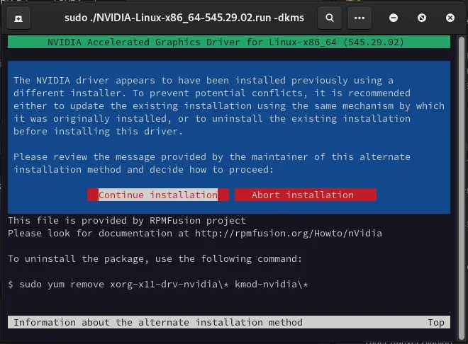

Merhaba, NVIDIA GeForce 3050 laptop ekran kartı sürücüsünü kurmaya çalışırken sorun yaşıyorum.
Log dosyam:
Kod:
nvidia-installer log file '/var/log/nvidia-installer.log'
creation time: Wed Jan 31 14:05:28 2024
installer version: 535.154.05
PATH: /usr/local/sbin:/usr/local/bin:/usr/sbin:/usr/bin:/sbin:/bin:/var/lib/snapd/snap/bin
nvidia-installer command line:
    ./nvidia-installer
    --dkms
    --no-opengl-files
Using: nvidia-installer ncurses v6 user interface
-> Detected 12 CPUs online; setting concurrency level to 12.
-> Tagging shared libraries with chcon -t textrel_shlib_t.
-> Installing NVIDIA driver version 535.154.05.
-> The NVIDIA driver appears to have been installed previously using a different installer. To prevent potential conflicts, it is recommended either to update the existing installation using the same mechanism by which it was originally installed, or to uninstall the existing installation before installing this driver.
Please review the message provided by the maintainer of this alternate installation method and decide how to proceed:
This file is provided by RPMFusion project
Please look for documentation at http://rpmfusion.org/Howto/nVidia
To uninstall the package, use the following command:
$ sudo yum remove xorg-x11-drv-nvidia\* kmod-nvidia\*
(Answer: Continue installation)
-> Performing CC sanity check with CC="/usr/bin/cc".
-> Performing CC check.
Halihazirda baska bir kaynaktan NVIDIA driveri yuklemissiniz, onu kaldirip yuklemeyi deneyin.
Neden runfile kullandiniz ki? Yaptiginiz seyleri tekrardan yapip runfile'i calistirdiginizda karsiniza NVIDIA driverlarini kaldiralim mi secenegi cikacak, oradan kaldirin ve RPM kullanarak yukleyin.
Maalesef, çıkmıyor.
Kod:
Bunu mu yazmam gerekiyor?
sudo dnf install akmod-nvidia yazdım şimdi.
Sorun düzelmedi, Minecraft'ta da Intel ekran kartını görmekte.
