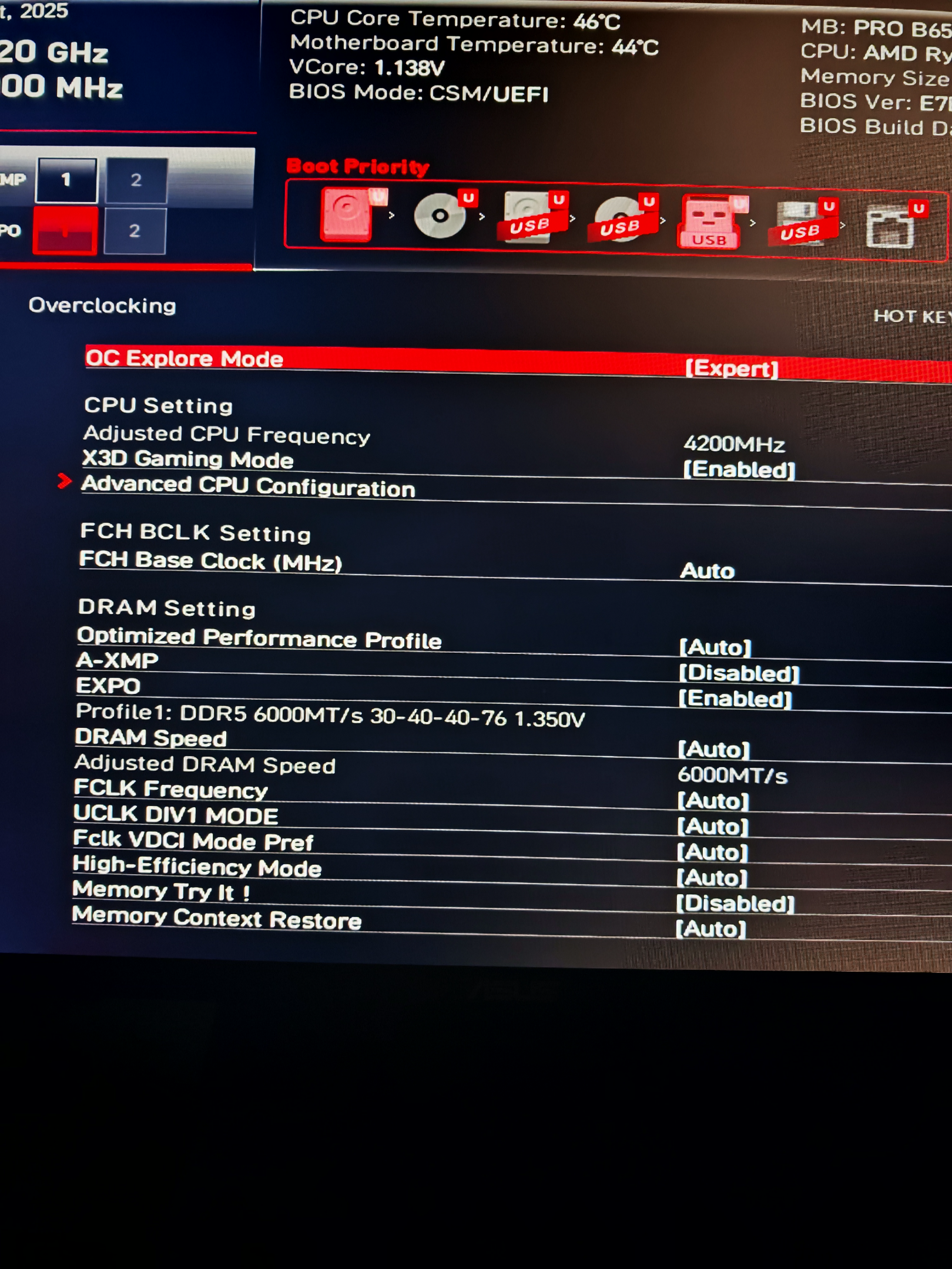

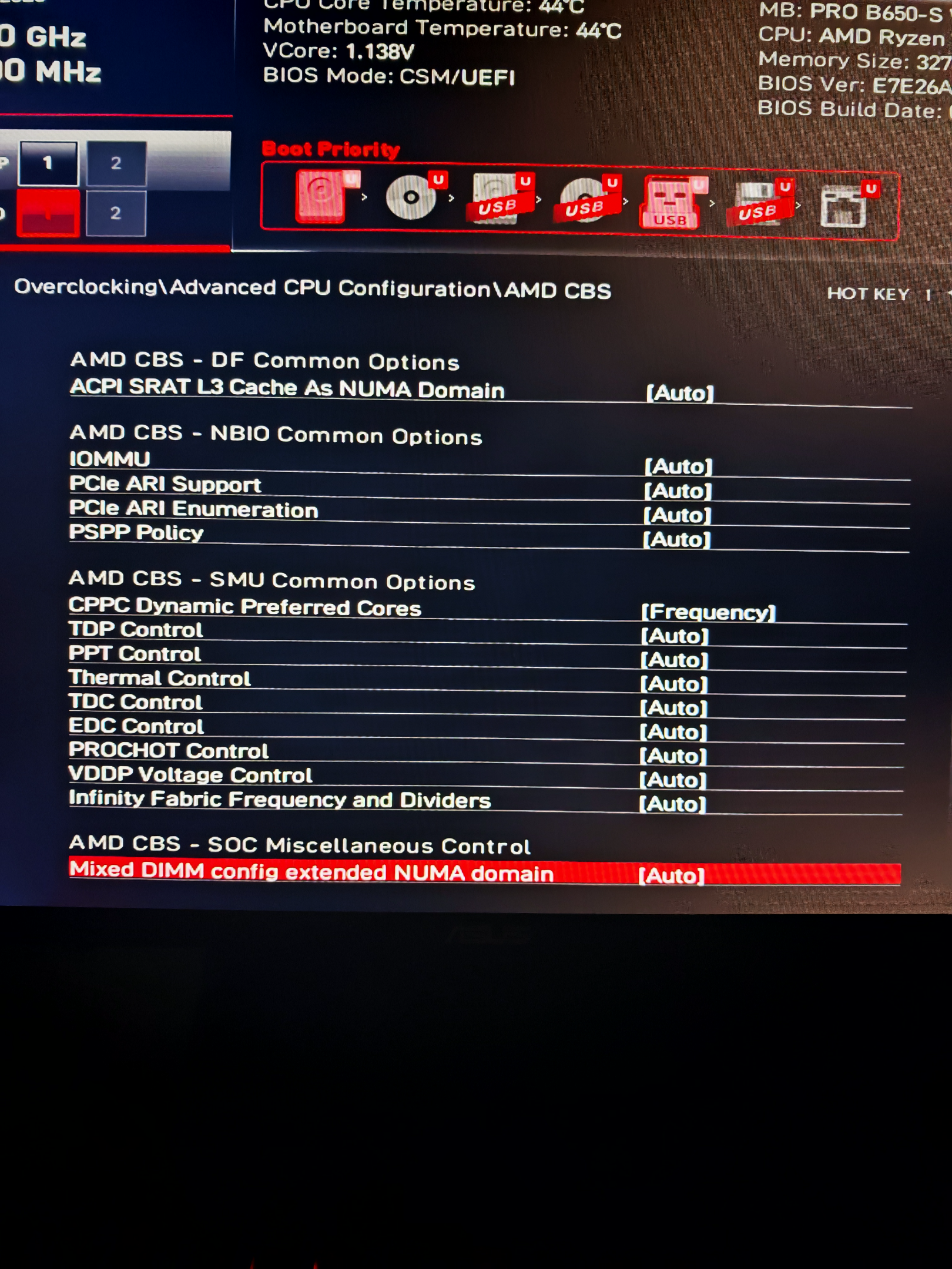

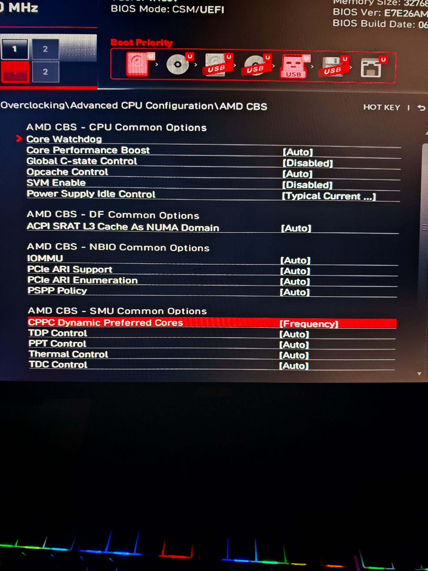

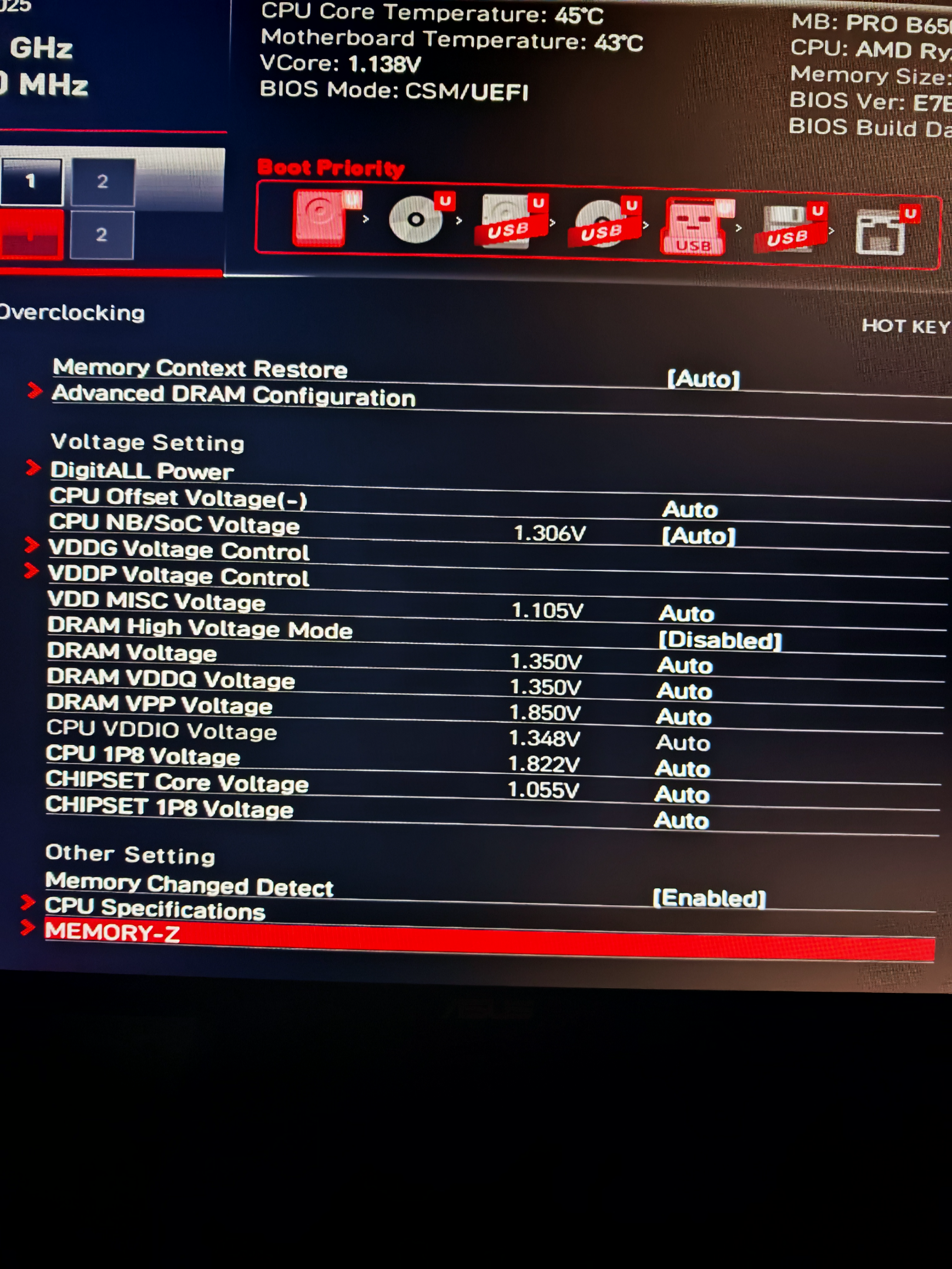

BIOS ayarları resimdeki gibi hocam yanlışlarımı belirtirseniz sevinirim.
Bir suru ayari yapmamissiniz hepsi duruyor Auto'da.
Memory context restore [Disabled]
Power down enable [Disabled]
Ibuf_lpwr_mode [Disabled]
Bank swap mode [Swap APU]
Core tunings Configuration for gaming [Level 2]
CPU load-line calibration [Level 1]
CPU Power phase Control [Optimized]
Performance bias [None]
Clock spread Spectrum [Disabled]
Security device Support [Disabled]
Password protection of runtime variables [Disable]
Pss Support [Disabled]
Nx mode [Disabled]
SVM mode [Disabled]
Above 4G decoding [Enabled]
ReSize BAR Support [Enabled]
Sr-ıov Support [Disabled]
Legacy USB Support [Disabled]
Xhcı hand-off [Disabled]
USB mass Storage driver Support [Disabled] flash bellek kullaniyorsan enabled.
Network stack [Disabled]
SATA controller(s) [Disabled] HDD kullaniyorsan enabled.
Max Power saving [Disabled]
HD Audio Controller [Disabled]
Serial port [Disabled]
Global C-state Control [Disabled]
IOMMU [Disabled]
ECC [Disabled]
L1 stream hw prefetcher [Enable]
L2 stream hw prefetcher [Enable]
L1 stride prefetcher [Enable]
L1 region prefetcher [Enable]
L1 burst prefetch mode [Enable]
L2 Up/Down prefetcher [Enable]
Core watchdog timer enable [Disabled]
Opcache Control [Disabled]
Streaming stores Control [Enabled]
ACPI _cst C1 declaration [Disabled]
Platform first error handling [Disabled]
Mca error Thresh enable [False]
Mca frutext [True]
Smu and PSP Debug mode [Disabled]
Ppın OPT-in [Disabled]
Smee [Disable]
AVX512 [Enabled]
CPU speculative Store modes [More Speculative]
SVM lock [Disabled]
SVM enable [Disabled]
Memory interleaving [Enabled]
Memory interleaving size [1 KB]
DRAM map inversion [Enabled]
Location of private Memory regions [Auto]
ACPI srat L3 cache as numa domain [Enabled]
Disable df to external downstream IP Sync flood propagation [Sync flood disabled]
Disable df Sync flood propagation [Sync flood disabled]
Freeze df module queues on error [Disabled]
Df cstates [Disabled]
PSP error injection Support [False]
tsme [Disabled]
Data scramble [Disabled]
Address hash bank [Disabled]
Address hash CS [Disabled]
Address hash subchannel [Disabled]
Bankswapmode [Swap APU]
Dfe read training [Enable]
PCI-e arı enumeration [Disable]
PCI-e arı Support [Disabled]
PCI-e all port ecrc [Disabled]
NB azalia [Disabled]
GPU host translation cache [Enabled]
Eco mode [Disable]
Launch CSM [Disabled]
Fast boot [Disabled]
BIOS ımage rollback Support [Disabled]
Publish hıı resources [Disabled]
Special display features [Disabled]
AMD variable protection [Disabled]
Processor aggregator device [Disabled]
LN2 mode [Disabled]

Başka bir BIOS modeline göre sanırım birçok yazı o yüzden aratıpta bulamadığım çok oldu bulduklarımı da şimdi uyguladım.
En az 20 tane ayar olmasi lazim bu ayarlardan eminim o konu da.
Hepsini tek tek aratip cikanlari yaptiysaniz tamam ama ben attiginiz SST'e en az 6 tane eksik gordum o yuzden ama siz yaptim diyosaniz tamam onun disinda interrupt affinity policy tool ayarini da yapin son olarak sonra tekrar test edip atarsiniz.
