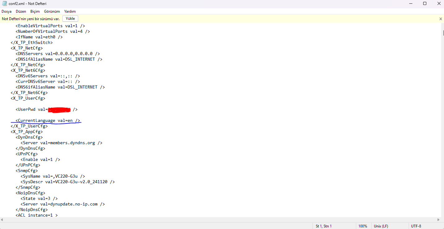

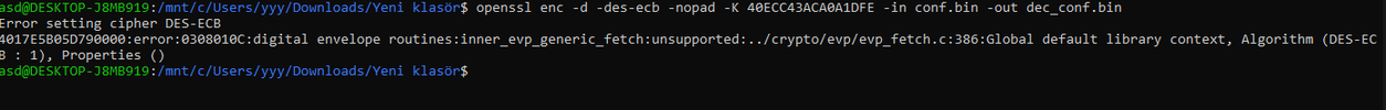

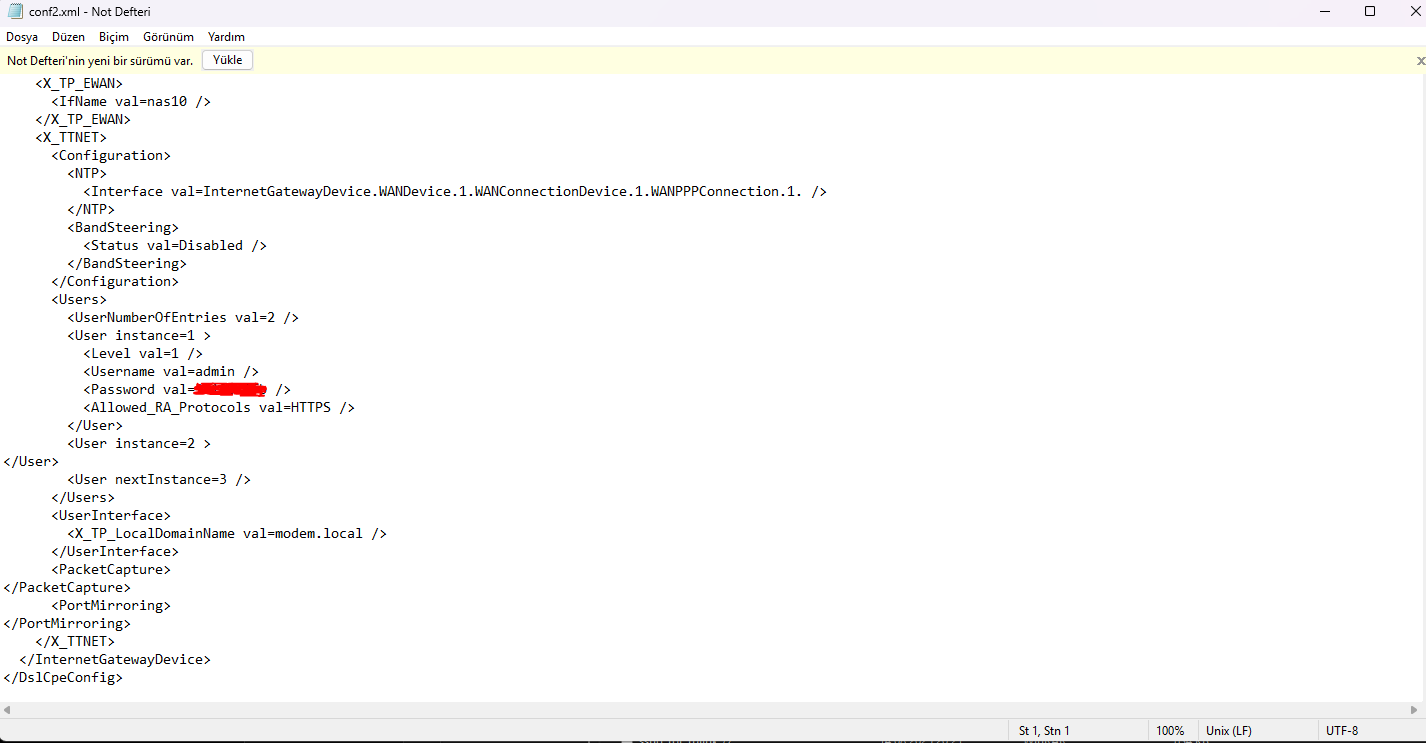

Full dump:
Güncelleme: Firmware Dump Edildi​
Root şifresini bulduk:
XML:
<?xml version="1.0"?>
<DslCpeConfig>
  <InternetGatewayDevice>
    <DeviceSummary val="InternetGatewayDevice:1.1[](Baseline:1, EthernetLAN:1)" />
    <LANDeviceNumberOfEntries val=1 />
    <WANDeviceNumberOfEntries val=3 />
    <DeviceInfo>
      <ManufacturerOUI val=984827 />
      <SerialNumber val=5CA6E60DF4FE />
      <HardwareVersion val="VC220-G3u v2 00000001" />
      <SoftwareVersion val=VC220-G3u-v2.0_241120 />
      <UpTime val=26 />
      <X_TP_DevName val=VC220-G3u />
      <X_TTNET_SerialNumber val=5CA6E60DF4FE />
      <X_TTNET_MACAddress val=5C:A6:E6:0D:F4:FE />
      <X_TTNET_ConfigVersion val=3 />
    </DeviceInfo>
    <ManagementServer>
      <URL val=http://hdmacs-tr069.ttnet.com.tr/cwmpWeb/CPEMgt />
      <Username val=9848275CA6E60DF4FE />
      <Password val=1762039826691a />
      <PeriodicInformInterval val=99001 />
      <PeriodicInformTime val=2025-11-09T15:46:24 />
      <ParameterKey val=5241795360 />
      <X_TP_connReqPath val=/4284 />
      <ConnectionRequestURL val=http://10.183.104.92:7547/4284 />
      <ConnectionRequestUsername val=5CA6E60DF4FE-VC220-G3u-984827 />
      <ConnectionRequestPassword val=799bdf07ef897507c4cf159209c37ea5 />
      <X_TP_Flag val=1 />
      <X_TP_BoundIfName val=nas10_2 />
      <X_TTNET_ACS_IP_ETH val=127.0.0.1 />
      <Manual_uint32 val=2147483649 />
    </ManagementServer>
    <X_TP_EthSwitch>
      <EnableVirtualPorts val=1 />
      <NumberOfVirtualPorts val=4 />
      <IfName val=eth0 />
    </X_TP_EthSwitch>
    <X_TP_NetCfg>
      <DNSServers val=193.192.98.8,212.154.100.18 />
      <DNSifAliasName val=EWAN_INTERNET />
    </X_TP_NetCfg>
    <X_TP_Net6Cfg>
      <DNSv6Servers val=::,:: />
      <CurrDNSv6Server val=:: />
      <DNS6ifAliasName val=DSL_INTERNET />
    </X_TP_Net6Cfg>
    <X_TP_UserCfg>
      <AdminPwd val=wbQn09pp@G />
      <UserPwd val=admin />
      <DefaultAdminPwd val=wbQn09pp@G />
      <CurrentLanguage val=en />
    </X_TP_UserCfg>

        <IPInterface instance=1 >
          <Enable val=1 />
          <__ifName val=br0 />
        </IPInterface>
        <IPInterface nextInstance=2 />
      </LANHostConfigManagement>
      <X_TP_LANIPv6HostConfigManagement>
        <IPv6DNSWANConnection val=DSL_INTERNET />
        <RADVDEnable val=1 />
        <IPv6PDWANConnection val=EWAN_INTERNET />
        <PrefixDelegationWANConnection val=InternetGatewayDevice.WANDevice.2.WANConnectionDevice.1.WANPPPConnection.1. />
        <IPv6InterfaceNumberOfEntries val=1 />
        <IPv6Interface instance=1 >
          <Enable val=1 />
        </IPv6Interface>
        <IPv6Interface nextInstance=2 />
      </X_TP_LANIPv6HostConfigManagement>
      <LANEthernetInterfaceConfig instance=1 >
        <Enable val=1 />
        <Status val=NoLink />
        <Name val=eth0.2 />
        <__ifName val=eth0.2 />
      </LANEthernetInterfaceCo
nfig>
      <LANEthernetInterfaceConfig instance=2 >
        <Enable val=1 />
        <Name val=eth0.3 />
        <__ifName val=eth0.3 />
      </LANEthernetInterfaceConfig>
      <LANEthernetInterfaceConfig instance=3 >
        <Enable val=1 />
        <Name val=eth0.4 />
        <__ifName val=eth0.4 />
      <LANEthernetInterfaceConfig instance=4 >
        <Status val=Disabled />
        <Name val=eth0.5 />
        <__ifName val=eth0.5 />
      <LANEthernetInterfaceConfig nextInstance=17 />
      <WLANConfiguration instance=1 >
        <__apLastStatus val=1 />
        <Enable val=1 />
        <Name val=wlan0 />
        <AutoChannelEnable val=1 />
        <X_TP_PreSSID val=TP-Link_2.4GHz />
        <SSID val=Techolay />
        <BeaconType val=WPAand11i />
        <X_TP_MACAddressControlRule val=deny />
        <X_TP_Bandwidth val=Auto />
        <X_TP_OperationalBandwidth val=20M />
        <X_TP_MaxAssoc val=32 />
        <Standard val=b,g,n />
        <WPAEncryptionModes val=AESEncryption />
        <WPAAuthenticationMode val=PSKAuthentication />
        <IEEE11iEncryptionModes val=AESEncryption />
        <IEEE11iAuthenticationMode val=PSKAuthentication />
        <X_TP_PreSharedKey val=Tech0layTech0lay />
        <SSIDAdvertisementEnabled val=1 />
        <TransmitPower val=100 />
        <AutoRateFallBackEnabled val=1 />
        <DeviceOperationMode val=InfrastructureAccessPoint />
        <WMMEnable val=1 />
        <X_TP_ShortGIEnable val=1 />
        <VlanID val=4001 />
        <X_TP_APType val=Primary />
        <X_TTNET_PSS val=2 />
        <X_TP_DefaultPreSharedKey val=7w3yEVynz7yT />
        <WPS>
          <Enable val=1 />
          <DeviceName val="Turk Telekom VDSL2 Modem Router" />
          <DevicePassword val=42213895 />
          <UUID val=0x000102030405060708090a0b0c0d0ebb />
          <ConfigurationState val=Configured />
        </WPS>
        <WEPKey instance
=1 >
        </WEPKey>
        <WEPKey instance=2 >
        </WEPKey>
        <WEPKey instance=3 >
        </WEPKey>
        <WEPKey instance=4 >
        </WEPKey>
        <WEPKey nextInstance=5 />
        <PreSharedKey instance=1 >
        </PreSharedKey>
        <PreSharedKey nextInstance=2 />
        <X_TP_MultiSSID>
          <MultiSSIDEnable val=1 />
          <MultiSSIDEntry instance=1 >
            <Name val=wlan1 />
            <SSID val=Misafir1_F4FE_2.4GHz />
            <SSIDAdvertisementEnable val=1 />
            <PreSharedKey val=zVcnvkUHvpt7 />
            <RadiusServerPort val=1812 />
            <MaxStaNum val=16 />
            <X_TP_APType val=Guest />
            <WEPKey instance=1 >
            </WEPKey>
            </WEPKey>
            </WEPKey>
            </WEPKey>
          </MultiSSIDEntry>
          <MultiSSIDEntry instance=2 >
            <Name val=wlan2 />
            <SSID val=Misafir2_F4FE_2.4GHz />
            <PreSharedKey val=NyqwCtkFD7Na />
            </WEPKey>
            </WEPKey>
            </WEPKey>
WEPKey>
          </MultiSSIDEntry>
          <MultiSSIDEntry instance=3 >
            <Name val=wlan3 />
            <SSID val=Misafir3_F4FE_2.4GHz />
            <PreSharedKey val=Lpupkf9b7X4a />
            </WEPKey>
            </WEPKey>
            </WEPKey>
            </WEPKey>
          </MultiSSIDEntry>
          <MultiSSIDEntry instance=4 >
            <Name val=wlan4 />
            <SSID val=LfMCLleK2lU2NueECKmOmzmNZOFQIL />
            <BeaconType val=11i />
            <PreSharedKey val=15NXCCJOpS9E7db2iAV9jbNcdaKuu />
            <X_TP_APType val=Backhaul />
            </WEPKey>
            </WEPKey>
            </WEPKey>
            </WEPKey>
          </MultiSSIDEntry>
          <MultiSSIDEntry instance=5 >
            <Name val=wlan10 />
            <SSID val=cUwksdkvPlDuRuh2BQ4nQcEFNH2uJK />
cation />
            <PreSharedKey val=yNZMfBVYqzKp0XhEAgx0Sx5wwOdAM />
            </WEPKey>
            </WEPKey>
            </WEPKey>
            </WEPKey>
          </MultiSSIDEntry>
          <MultiSSIDEntry nextInstance=6 />
        </X_TP_MultiSSID>
        <X_TP_WlBrName instance=1 >
          <IfName val=ra0 />
          <BridgeName val=br0 />
        </X_TP_WlBrName>
        <X_TP_WlBrName instance=2 >
          <IfName val=ra1 />
        </X_TP_WlBrName>
        <X_TP_WlBrName instance=3 >
          <IfName val=ra2 />
        </X_TP_WlBrName>
        <X_TP_WlBrName instance=4 >
          <IfName val=ra3 />
        </X_TP_WlBrName>
        <X_TP_WlBrName instance=5 >
          <IfName val=ra4 />
        </X_TP_WlBrName>
        <X_TP_WlBrName instance=6 >
          <IfName val=ra5 />
        </X_TP_WlBrName>
        <X_TP_WlBrName nextInstance=7 />
      </WLANConfiguration>
      <WLANConfiguration instance=2 >
        <Name val=wlan1 />
        <Channel val=8 />
        <BasicEncryptionModes val= />
        <X_TP_PreSharedK
        <WMMEnable val=1 />
        <VlanID val=4002 />
        <X_TP_DefaultPreSharedKey val=zVcnvkUHvpt7 />
        <WPS>
        </WPS>
        </PreSharedKey>
        <X_TP_MultiSSID>
        </X_TP_MultiSSID>
      <WLANConfiguration instance=3 >
        <Name val=wlan2 />
        <Channel val=8 />
        <X_TP_PreSharedKey val=NyqwCtkFD7Na />
        <WMMEnable val=1 />
        <VlanID val=4003 />
        <X_TP_DefaultPreSharedKey val=NyqwCtkFD7Na />
        <WPS>
        </WPS>
        </PreSharedKey>
        <X_TP_MultiSSID>
        </X_TP_MultiSSID>
      <WLANConfiguration instance=4 >
        <Name val=wlan3 />
        <Channel val=8 />
uthentication />
        <X_TP_PreSharedKey val=Lpupkf9b7X4a />
        <WMMEnable val=1 />
        <VlanID val=4004 />
        <X_TP_DefaultPreSharedKey val=Lpupkf9b7X4a />
        <WPS>
        </WPS>
        </PreSharedKey>
        <X_TP_MultiSSID>
        </X_TP_MultiSSID>
      <WLANConfiguration instance=5 >
        <__apLastStatus val=2 />
        <Enable val=1 />
        <Name val=wlan5 />
        <X_TP_PreSSID val=TP-Link_5GHz />
        <SSID val=Techolay_5GHz />
        <X_TP_Band val=5GHz />
        <X_TP_OperationalBandwidth val=80M />
        <Standard val=a,n,ac />
        <WMMEnable val=1 />
        <VlanID val=4001 />
        <WPS>
          <Enable val=1 />
nfigured />
        </WPS>
        </WEPKey>
        </WEPKey>
        </WEPKey>
        </WEPKey>
        </PreSharedKey>
        <X_TP_MultiSSID>
            <Name val=wlan6 />
            <SSID val=Misafir1_F4FE_5GHz />
            <PreSharedKey val=RzhPHcUxCpT3 />
            </WEPKey>
            </WEPKey>
            </WEPKey>
            </WEPKey>
          </MultiSSIDEntry>
            <Name val=wlan7 />
            <SSID val=Misafir2_F4FE_5GHz />
            <PreSharedKey val=kJC7LenqgpjU />
            </WEPKey>
            </WEPKey>
            </WEPKey>
            </WEPKey>
          </MultiSSIDEntry>
            <Name val=wlan8 />
            <SSID val=Misafir3_F4FE_5GHz />
            <PreSharedKey val=wkDXcR4WgWxg />
            </WEPKey>
            </WEPKey>
            </WEPKey>
            </WEPKey>
          </MultiSSIDEntry>
            <Name val=wlan9 />

Abi bulduğun keyi deniyorum fakat böyle bir hata veriyor. @Recep Baltaş
    6,8 KB · Görüntüleme: 609

Kırdıktan sonra içinde root kullanıcısı yok elimle senin attığın Config dosyasından kopyalayıp ekliyorum sonra şifreleyip modeme yüklüyorum fakat yükledikten sonra sanki otomatik olarak root kullanıcısı siliniyor. <CurrentLanguage val= en /> komutunu eklediğimi bildiğimden anladım bunu. Yedekleyip tekrar kontrol ettiğimde gerçekten silindiğini anladım. Bir şeyimi atlıyorum yoksa 241120 Firmware'de fixlenmiş olma ihtimali var mı?
